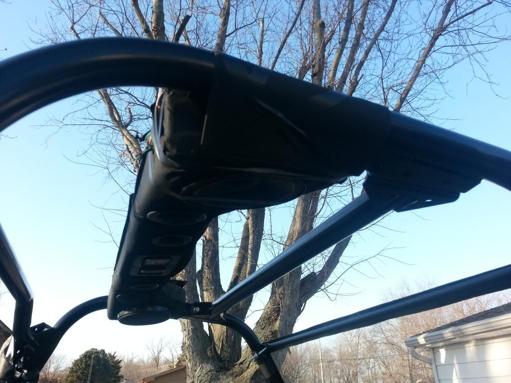

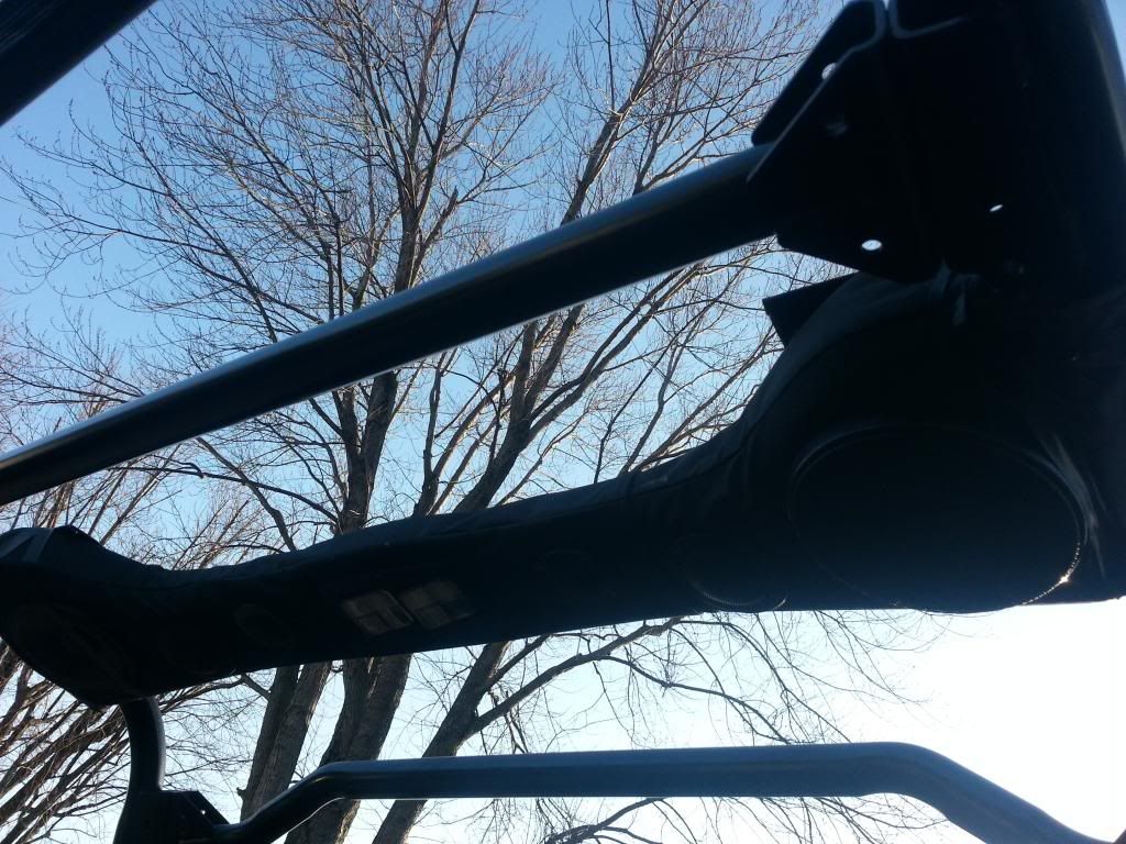

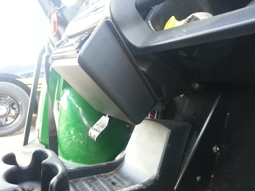

Long time viewer, first time poster. Joined the forum in August 2012 after i finally purchased my 825 i. Just thought I would share a cheap (less than $150.00) Stereo install. Picked up a CD player \ Radio $50.00 at Wal Mart, Under dash mounting kit $ 15.00 at Bass Pro Shop, Sound / speaker bar out of a Jeep Wrangler $40.00 from local junk yard, misc wiring and connectors $20.00. I did all of this with a no drill install. The CD player was mounted under the dash using 3M double sided tape. Ran all of the wiring inside the OPS and had it come out the factory opening at the cross member. All wiring was hidden inside the center console. Just thought I would share, did not want to dump a ton of cash on a radio was happy to find that the Jeep speaker bar fit. Thanks, look forward to any comments, good or bad!
