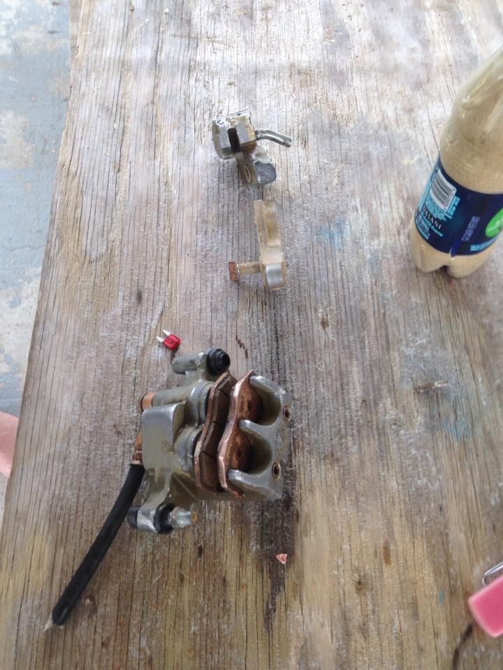

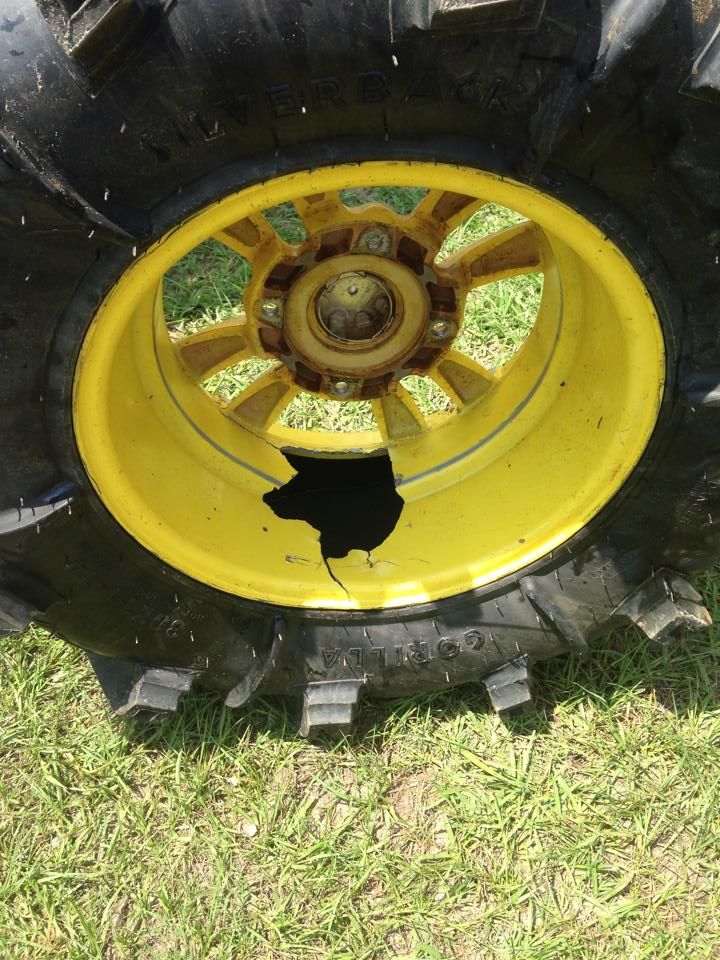

I really hate it for you man, sounds like you got a lemon. I ride with Polaris all the time and usually its those that are being winched out if they come out at all... That being said, I had a bit of user error this past weekend whenever I changed my axle out. Last Saturday whenever I threw my Gator into reverse down at the creek the caliper evidently came loose and went through the wheel. After closer inspection I deemed the point of failure to dirt getting into the bolt and not allowing it to tighten up properly, or I may not have gotten the bolts tight in the first place... But I'd rather blame it on the dirt than seek a new profession lol.
And I pulled this out of the wheel..
But after a new wheel, caliper, lines and fluid I have a very valuable "bought lesson" to double check my work more thoroughly in the future. Still the only problems I've been having out of the Gator have been 110% my fault. Great machine.
